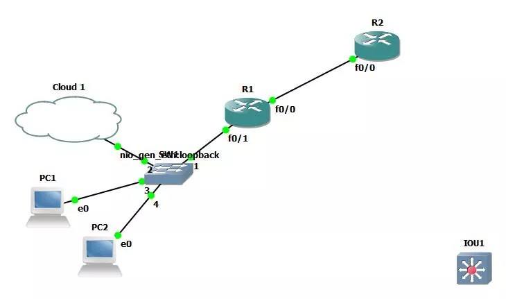

11 years 9 months ago #38597
by sharo
please help me for this simple configuration was created by sharo
if i have two network and i have one switch if the switch is simple switch can't configure and one network is private
ip and another is public ip how to configure it.
thanks for response
thanks for response

Replied by Chris on topic please help me for this simple configuration
Sharo,
Have you found a resolution to your problem yet?
If I understood your problem correctly, you'll need a router or a multilayer switch to be able to connect it to your could, assuming its a lab. In the real world, you'll need another router that connects the could to the switch. The router will also need to perform Network Address Translation (NAT) - another reason why a switch wouldn't work as they cannot perform NAT.
Do let us know if we can further help you.
Thank you.
Chris.
Thank you.
Chris.
