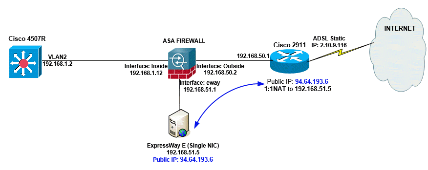

11 years 5 months ago - 11 years 5 months ago #38652
by Chris
Chris Partsenidis.
Founder & Editor-in-Chief
www.Firewall.cx
Replied by Chris on topic Firewall baseline configuration
SkyLimit,
You're mostly welcome.
Regarding the 'guide' your looking - I search and found exactly what you need.
Check out this Cisco URL which is basically part of the Enterprise Edge Design Guide. For your reference, 'best practices' for setups, configuration, services etc are called 'Design Guides' for Cisco. These are the key words for your search
www.cisco.com/c/en/us/td/docs/solutions/...G/SAFE_rg/chap6.html
The router is usually used to terminate the different WAN lines to the network, e.g ADSL, Ethernet WAN, Serial line and more. The other great thing about routers is that they are extremely flexible with multiple WAN connections as you can perform Policy-Based Routing (PBR) ( www.firewall.cx/cisco-technical-knowledg...a-auto-redirect.html ) and load-balance users between multiple connections, use IP SLA for automatic failover and much more...
Finally, regarding the section that wasn't clear, what I meant is that when you have a Firewall and router in front, I usually configure the Firewall's WAN interface with a private IP (192.168.50.2), rather than a Public IP. This is shown in the diagram. I then use NAT to either create a one-to-one mapping with an internal host (ExpressWay-E Server) or simply port-forward only the ports required to the internal host (DMZ Zone always!!!).
Hope that helps clear things up. Let me know if you have any questions.
Chris.
Chris.
Chris Partsenidis.
www.Firewall.cx
Last edit: 11 years 5 months ago by Chris.
